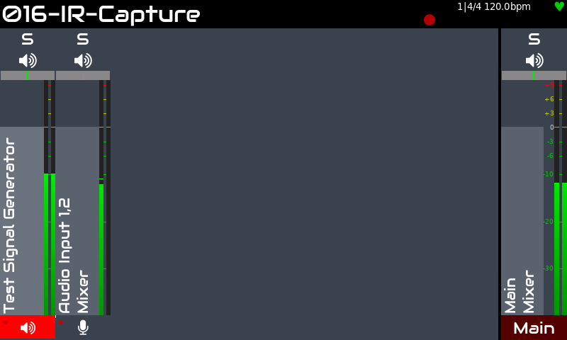

so we configured the zynthian with 2 chains like this:
Chain 1 => Audio Generator Chain
=> Test Signal Generator processor
=> Enable Mixer’s Recorder
Chain 2 => Audio Input Chain
=> No processors
=> Configure Audio Input as needed, with 1 or 2 mics
For recording, we simply used the REC button in the V5. Super-easy. When recording with 1 mic, the captured mono signal is duplicated on-the fly so the workflow stays completely consistent.

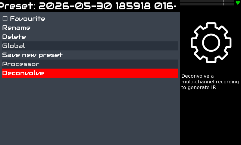

Then, you can deconvolve both signals to get the IR. From the audio captures list, bold-press on the audio file to get the options:
The “deconvolve” options is only shown for multi-track audio files with 4 or more tracks. The first 4 tracks are used as explained above.

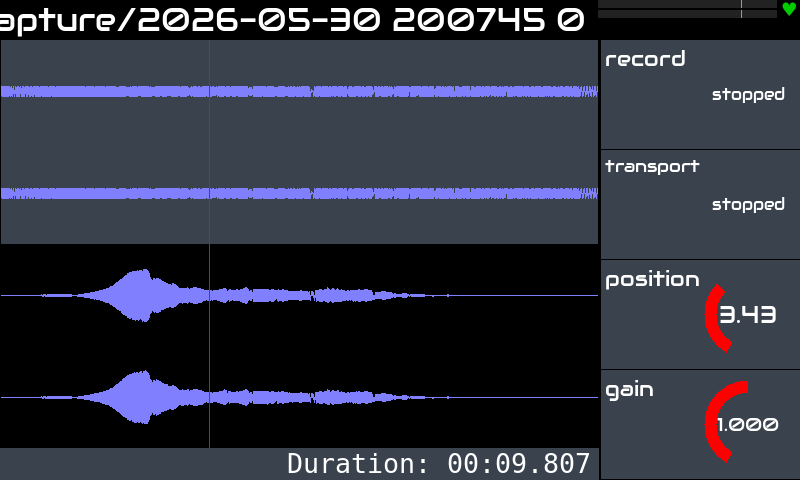

OK! A clap recording example:
Of course, some gain adjustments are needed to get a good recording. This depends a lot on the gear used for the recording (mics, audio interface, space, etc.), so i’m not going to elaborate on this kind of details. Enough to say you need to put some care in these details.
